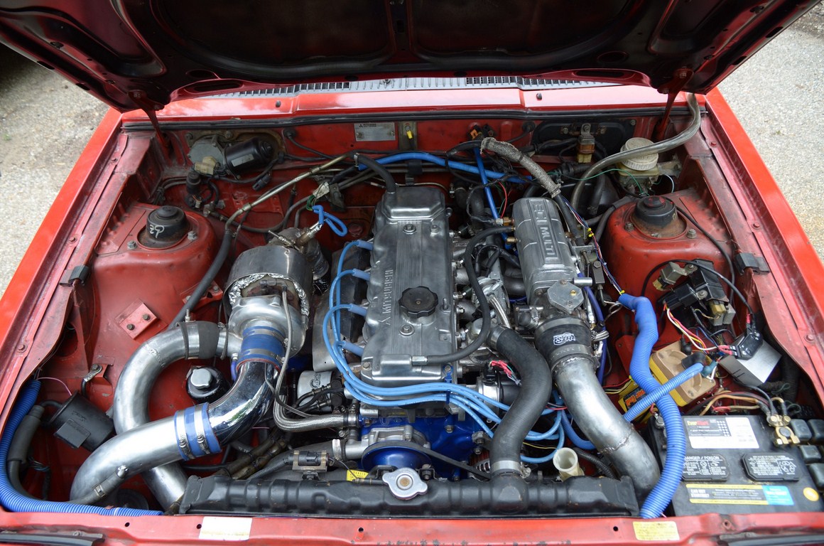

Well Progress has been alot slower then I have liked it to be, but I still am making progress on my Starion. Got the Bottom end almost all together with oil pan and Timing cover on. Took alot of work to get the Crank Scraper fitting just right with grinding, plus use a few washers to make the oil pickup even in the pan as it was originally.
Doing alot of small improvements over the last setup from the blue car (12.4 @ 15psi).
Other Notable things I am Changing or considering to change, Going from 2.5in to 3in after the IC to the TB, Moving BOV from After IC to Before near the turbo.
Italic = Changes from Blue car
Car Info:
Hawk ECU
Magna Intake
60-1 Hifi Turbo
720cc injectors
88 Starion Red Repainted by Burton several years ago.
Transmission: Stock 88 Automatic Transmission (so far Want to clean and VB mod, probly over the winter)
Polly Trans Mount
Engine: G54B Same engine, Exhaust, intake and Turbo ran 12.4 @ 15psi in the Blue car (main difference is this in a auto with much improved head)
8.1:1 Compression (about)
Custom Weisco Forge Pistions (desinged to give an even 7:1 ratio with Marnel head)
Crank Scraper
Oil pan baffle
BS Eliminated
Rebuild and Balanced
Light Wight 83 Crank Pully (no ac belt groove)
Intake:
65mm Australian Ford TB
Magna Intake (Plenum Ported to have smoother transition from Welded flange to intake)
3in Cold air intake K&N Filter Filter is down where the charchol canister use to be
2.5In pipe from Turbo to IC With Tial BOV
3in from IC to TB
Inter cooler pipes just under 4ft long in total
Volvo Buss IC with 3in in and outlets. (front bumper Cut and rewelded and modified to get about 25% more flow from the blue car)
Fuel:
Delphi Injectors from RC engineering injectors 718cc flowed to 1% of each other
Magna stock FPR 37psi 0 vac and 26psi 17 vac (haven't tested under psi yet)
Fuel Pressure gage Mounted on the Cowl
Have a Arrowmotive FPR I may install later
Head:
Magna 3rd gen head (heart shaped chambers raise compression to about 8.3:1 from stock)
Magna 3rd gen Roller Cam 1.55 Ratio Rockers (have some Caravan 1.6 ratio I may put in later to see how it works)
Very Heavily Ported
SS 1mm Oversized Valves
Shniter HD Valve Springs
Ti Retainers
Manual Carb Fuel Pump access welded Up so dont need to worry about oil leaking
Factory set up for Crank ventilation. (secondary air Cleaner)
Exhaust:
3in exhaust from downpipe to the stright section, 3.5in at the bend in the rear with 3.5in Cherry Bomb
2 3 Wire Narrow Band O2's One for ECU other for AF Gage
(Plan to add another O2 Bung down farther for Wide Band)
38mm External WG Routed back into downpipe (about 25% more flow then the blue cars)
V band exhaust connections
Exhaust Wrapped downpipe
Turbo Insulation blanket
SS Heat Shield over the blanket
SS Heat Shield around the Header
Header designed for Waste gate Flow
ECU:
Hawk EC21 2 Injector Driver Batch inj Setup
Controlling Ignition and fuel
Ignition:
4 Wire Ignitor with Alumin Plate and CPU Heat Sink
Accel Super Coil
Moroso Ignition Wires (using old set will make a new set Before its going again)
Accel U Groove Spark Plugs
Magna Distributor
Turbo:
Turbonics T3/T4 60-1 HiFi Stage 3 Turbine
Greddy Profect B Boost Controller (Not Installed yet)
Will get some pics up soon. here is a smal vid of it reving.... going to be fun might ned a lager turbine i think.http://www.youtube.com/watch?v=TbodO2t3CLw&feature=player_embedded
